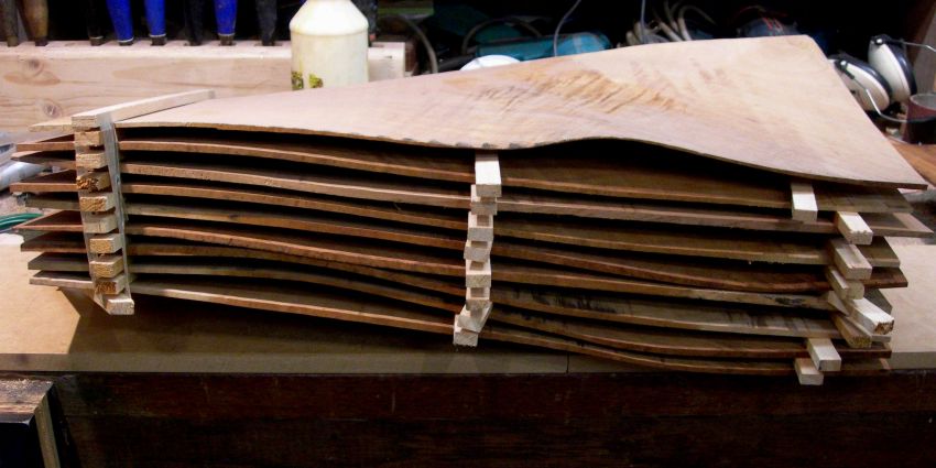

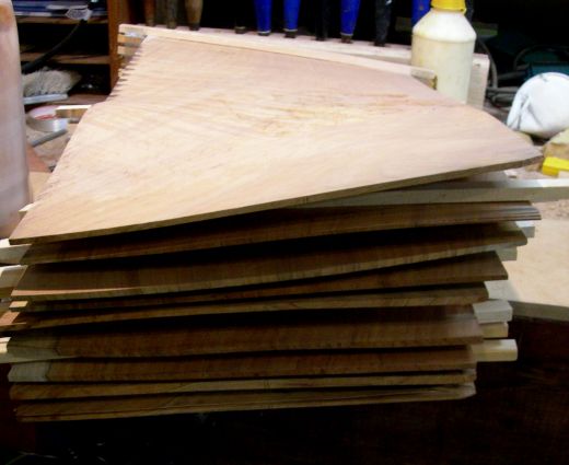

I hope that you will never end up with sets like these but this is what can happen when the blackwood has been exposed to one or more of the following conditions.
1. Resawn unseasoned and left without sufficient strapping and stickering.
2. Exposed to a dramatic moisture reduction with or without stickering.
Blackwood from my experience in the resawing process benefits from some initial racking out before being resawn into sets. There is also some tension present in most boards with the highly figured material being most prone to movement if not restrained. Following the seasoning process Blackwood is very stable and a joy to work.

I have watched in horror with my own eyes as veneers sliced from this 15" deep board of unseasoned blackwood cupped and buckle dramatically as they sliced from the billet.
Not only did the veneers themselves move like a worms as they came from the new blade, also to did the 1 1/4" thick billet cup against the fence with such force that it was beyond mere mortal to control...
Beauty does cometh at a price my friends. Beware he who should be tempted to claim her too early less she fly from thy hands to be lost forever.

Perhaps foolishly, I bought a couple of sets of Brazilian Rosewood from one
of the ebay sellers that... how should I say it... has a bit of a problem with
the English language. Anyhow, spent nearly as much on shipping as the sets
cost so I wasn't expecting great things. Well, after a few days in my humidity
controlled basement (45-50%) they looked like the potato chips you have
pictured here. Won't do THAT again!
Is there anything that can be done at this point? I think I've read about using
a steam iron...

Cameron, do you have a heat blanket? If so, lay the heat blanket on your BRW with a piece of scrap ply over top ....heat and and clamp.
PostPosted: Sun Sep 03, 2006 5:21 am
Cameron, I had a similar problem with a side of walnut too! I wetted the side and wrapped it in parchment paper, layed it on a piede of ply wood and ironed it with a wet rag and heat blanket. after nice and hot a placed another piece of plywood on top and clamped pretty tight (without the rag ) for a few days, tightning the clamps a bit every time I walked by or remembered.... after a week the side was straight as can be!
